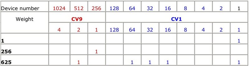

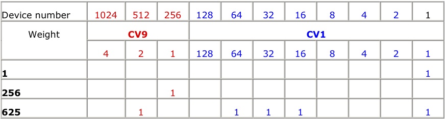

Te adjunto un documento, básicamente viene a decir que la variable que tienes que tocar es la CV1 -> y poner en ella el codigo del desvio, y si quieres un número mayor a 255 se pone conjuntamente con la CV9 tal como indica la tabla.
Device address setting
The decoder is addressed with device adress according to the Roco
Multimouse device numbering. Setting device address of 1 results in
decoder responding to commands sent to turnout number 1 from
Roco Multimouse.
Addresses from 1 to 256 are set in CV1, when CV9 is set to 0. To
set addresses higher then 255 the folowing formula should be used:
CV9*256+CV1 = device address
for example,to set address of 256 write value of 1 into CV9 and value of 0 into CV1, to set device address of 625 programm value of 2 into CV9 and value of 113 into CV1. The following table could be helpfull when calculating CV1 and CV9 values:
The table contains examples for calculating device numbers of 1, 256 and 625. Use values from first row to calculate the desired device address, for example to achieve the value of 625 sum up the following values 512+64+32+16+1. Write ones in columns crresponding to selected values. In the next step add together blue values from third row (from columns marked befor with ones) to get CV1 value(1+16+32+64 = 113) and in the same way add together red values to get CV9 value (2) . Write calculated values to corresponding CVs. In this way 2048 of device addresses can be calculated. (With MultiMouse only addresses from 1 to 1024 can be used).
